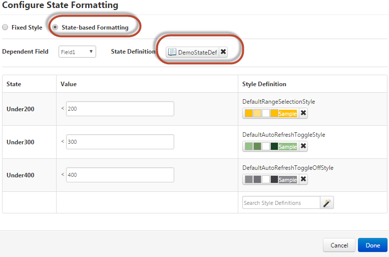

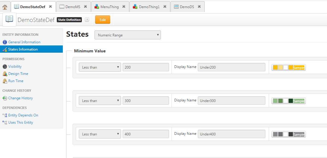

spandana, you will have to create state based formatting and assign colors for e.g.
1. Create State Definition navigate to Composer > Visualization > Sate Definitions > New

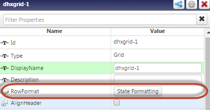

2. Navigate back to your Mashup select the Grid in the Properties for the Grid click on the State Formatting Value for RowFormat, like so
3. On the Configure State Formatting window , select Sate based formatting and then select the state definition created
Hope this helps.

sdaram1-VisitorAuthor
April 30, 2017
Issue got resolved thank you using Dependent column in StateFormatting
