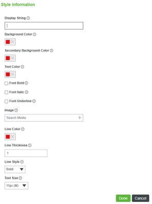

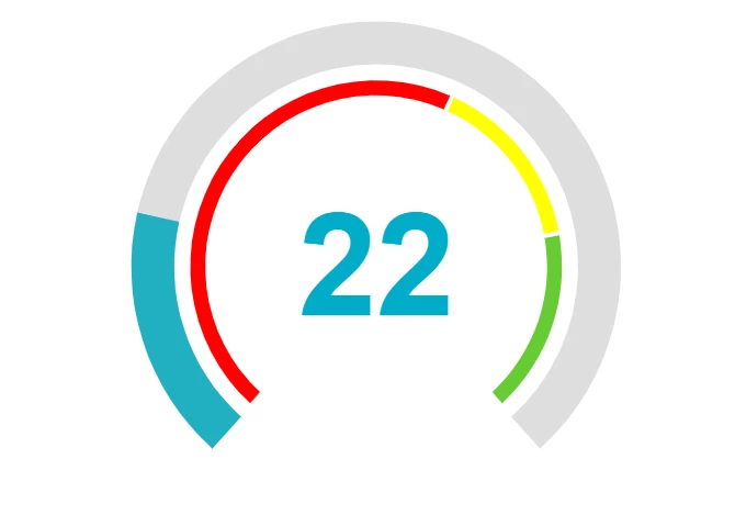

Problem: I want to implement to change the inner value colour of the ThresholdIndicatorWidget according to OEE property value. meaning if OEE value is below 60 then inner value colour should be RED likewise OEE value below 80 -> Yellow and below and equal to 100 -> Green.

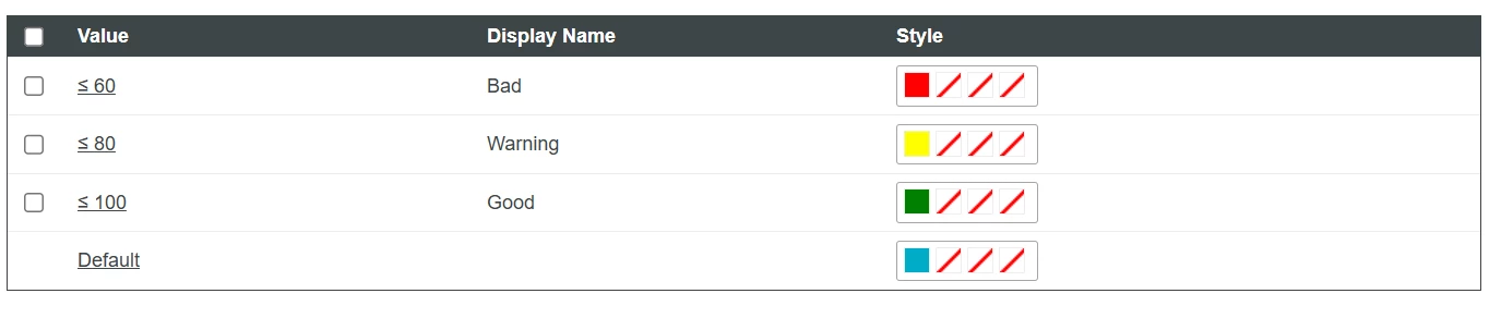

I am attaching a screenshot of that widget in the name of ThresholdIndicatorWidget.png, PFA. In this image, 22 number value should be in RED colour. For inner indicator bar I have attached a new State Definition for this widget instead of its default state definition. I am attaching the image in the name of StateDefinition.png for your reference. Due to this state definition inner value colour is not changing accordingly.

  • I have applied your approach but still no luck.
  • This is not the KPI dial widget, it is a ThresholdIndicator widget. KPI dial widget is not available in the Thingworx 9.4.6 version.
  • In my state definition I have set background, secondary background, text and line colour to red and do it for yellow and green colour as well.
  • My state definition is based on Number not a String .
  • See the above attached images for your clarification. Please, let me know if you need any other information

Sep 23, 2025 6:28 AM UTC
I only have KPI dial here so it may be different. What you can try is to unset the state formatting property on the widget, save it, and then re-set the state def you created. I needed to do this for the system to load the changes in the styles of the State Definition. If that doesn't help it might be a bug.
