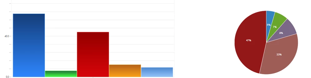

I am trying to match the colors in the label chart widget by changing the segment colors in the d3 pie chart widget.

However, after the change, it is still displaying the old colors.  Is the extension not referencing these color codes anymore?

It appears that the color is being assigned from the Style definitions (line 226-229 in the runtime js file)
if (formatter != undefined) {
 formatResult = TW.getStyleFromStateFormatting({ DataRow: rows[i],
 StateFormatting: formatter });
 value.color = formatResult.backgroundColor;
I wonder if removing that would force it to use the code you referenced above.
Nick
June 28, 2022
Actually that may not be the cause.  Did you replace the d3pie.min.js with a non-minified version  of the library?
