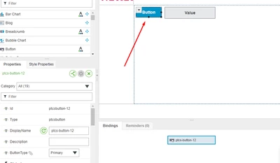

Hi, I'm building my smart home. I want to click on Button, it will change color or text for 2 states. How can i do?

Hi @Nguyen_Khue ,
There is a property on each visual widget called CustomClass. You can have your service output to it 2 different strings.
Your CSS should look something like this
.myFirstButton ptcs-button {
 color: red !important;
 background: yellow !important;
.mySecondButton ptcs-button {
 color: yellow !important;
 background: purple !important;
"myFirstButton" and "mySecondButton" being the 2 different strings you output from your service. ofc you can change them to whatever fits your context.
