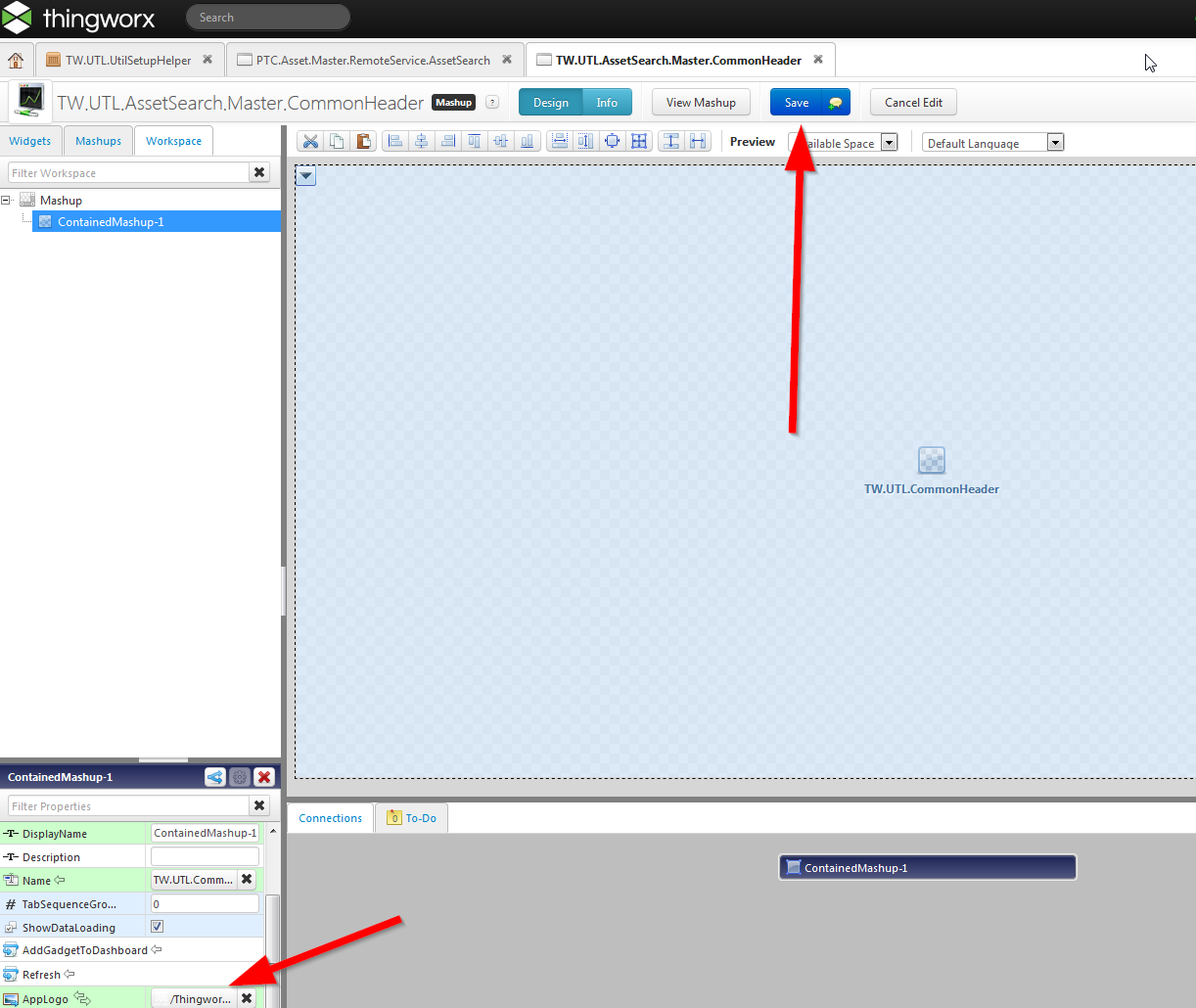

Ref. the ThingWorx Utilities Help Center:
Changing the Logo in the Banner
The problem is that the media entities are locked for edit.
Anyone knows best practices how to handle this?

  You are now allowed to create a new media entity? This should solve your problem. The lock for edit on media entities should be only for the ones that TWX comes by default, but you should have access on creating a new media entity.

I agree about that, but then I would need to duplicate the mashup that contains the "header" (banner), and then I would need to also duplicate several related files. Is this the way to go about this?
June 1, 2016
    Not really. You don't need to duplicate the mashup. All you have to do is edit the mashup, from the Properties of the widget, find the style that references the logo and just upload the media entity that you created.

Hey Tommy,
as this is still unanswered and I recently stumbled across this issue (and the docs will not help you how to do it): You need to create your own Media with the logo you want. Then you have to edit the Mashup "TW.UTL.AssetSearch.Master.CommonHeader": Select the ContainedMashup (see Workspace tab) and in the properties (left bottom) you can change the AppLogo to your previously created one. This Mashup can be saved and you are good to go.
