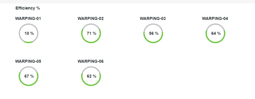

how to change the shape stroke color based on a customclass name
I have created a mashup and used it in collection and am not able to change the stroke color using Custom CSS kindly some one advice what i need to do, do give the shapes different color based on their name.
22-Sapphire I
Have you tried using state based definitions?
The widget should have certain properties that I think are called 'formatter' to allow for a state based definition to be associated.
https://support.ptc.com/help/thingworx/platform/r9/en/index.html#page/ThingWorx/Help/Composer/Visualization/StyleandStateDefinitions.html
Yeah, in that shape already data is binded from a different property so i cannot map the Machine name function to it.
22-Sapphire I
You could always create a wrapper service to combine the necessary information you need.
