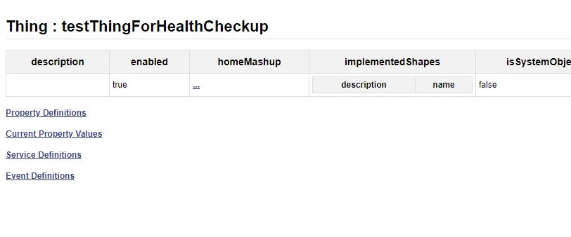

Oct 28, 2020 7:53 AM UTC
Hi @raluca_edu ,
I am able to get response only for any property of a thing (Only for GET Request, not with POST) but not able to execute service using below url (both with GET and POST) :-
http://<Thingworx Ip>:8080/Thingworx/<entity collection>/<Entity Name>/Services/<ServiceName>
Above url is giving response only till .....<Entity Name> and for further it is showing "Invalid request" because "Services" link is not displaying. (Screenshot enclosed)
Actually, I want to execute the services of Subsystem using Rest Call.
Can you help me on how to execute the service.
Oct 28, 2020 8:43 AM UTC
Hello @ranjank,
To execute a service in ThingWorx via Postman you have to use the POST option.
More information can be found under Updating, Deleting, and Executing Through the API
