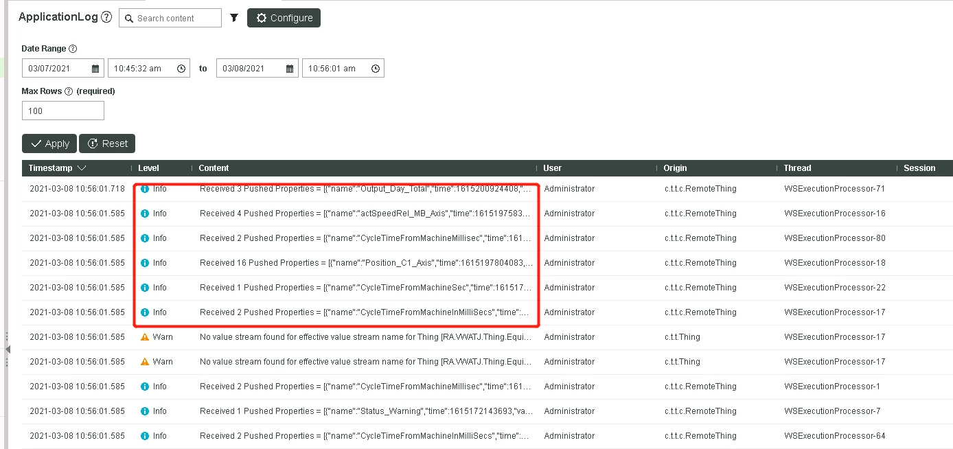

How to configure the application log generated by Remoting properties changed
I see a lot of logs generated by PLC tag attribute changes in the logs, these logs don't mean much to me, and there are more remote devices, so they generate a lot of logs, can I configure somewhere to turn off this kind of logs? Thank you!

Hi @CZ_9645217
The log entries for PLC tag attribute changes are in info, you can update the log level to display error, warn or other level of logs only. Refer this article to update the logging level.
