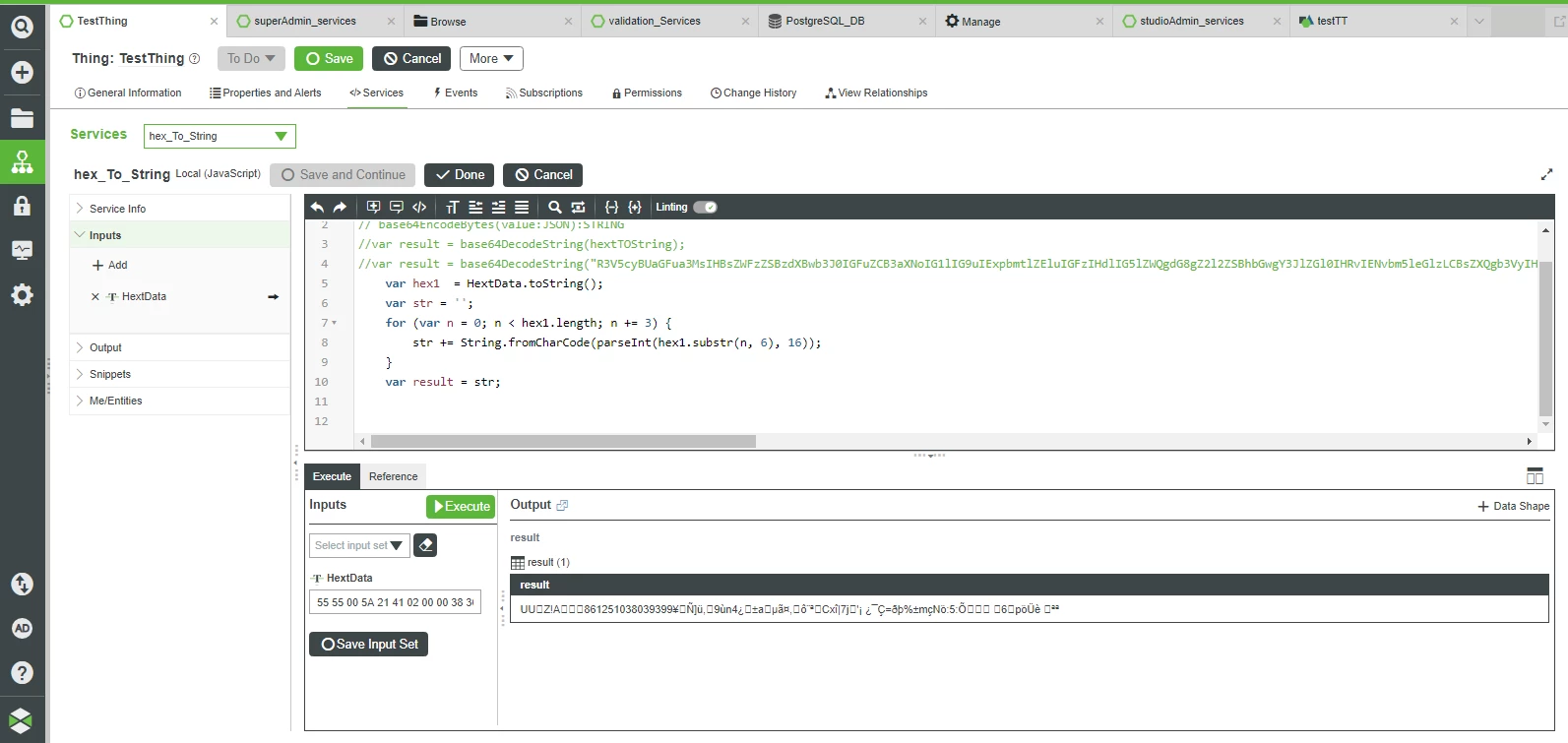

2.    I have sensor data in the hex format which in the attachment file, I want to convert it into a readable format.
I have tried with some javascript program which is given below but it is giving me the wrong result please check attachment for output. please suggest
 var hex1 = HextData.toString();
	var str = '';
	for (var n = 0; n < hex1.length; n += 3) {
		str += String.fromCharCode(parseInt(hex1.substr(n, 6), 16));
	var result = str;
Does anyone know how to work? Much appreciated.

  2. Hex data converted to string. I put the data into a hex to ascii conversion page and I did not get readable text. I may not understand what you trying to decode. This is what I see:

In the second question,
I have some hex data which was sent by my client and I received it from my end.I have to convert that hex data into a simple human-readable format( consider English).
Please check below hex data sent by the client.
55 55 00 5A 21 41 02 00 00 38 36 31 32 35 31 30 33 38 30 33 39 33 39 39 A5 08 D1 5D FC 2C 82 39 F9 6E 34 BF 14 B1 61 89 B5 E3 A4 2C 88 F4 A8 AA 0B 43 78 EE 7C 37 6A 94 27 A1 20 BF AF C7 3D F0 FE 25 B1 6D E7 4E F6 3A 35 3A D5 0F 91 83 0D 80 36 97 70 F6 DC E8 0A 81 AA AA
UU *!A 861251038039399ûGæ¦l-*Rá-+ph顱¬¬
how we can get proper data conversion so we can read the data what exactly it is.
please suggest
@Suraj2692 ,
I am not sure I can assist with the translation you are requesting. The hex data which is being returned may not be ascii information. When I place the information in a web page which converts HEX to ASCII I get
"UUZ!A861251038039399¥Ñ]ü,‚9ùn4¿±a‰µã¤,ˆô¨ª Cxî|7j”'¡ ¿¯Ç=ðþ%±mçNö:5:Õ‘ƒ
€6—pöÜè
ªª"
which is similar to the strings displayed at the bottom of the hex data. When I look at the data a byte of "00" is sometimes to terminate a   string. If that is the case then the entire string is "UU"? If you know the format of the data, a translation might be possible. If you divide the HEX bytes into the proper groups then the values can be translated. The HEX bytes might represent values and not ASCII characters. If you know what is sending the HEX characters it may provide the description of the information.
