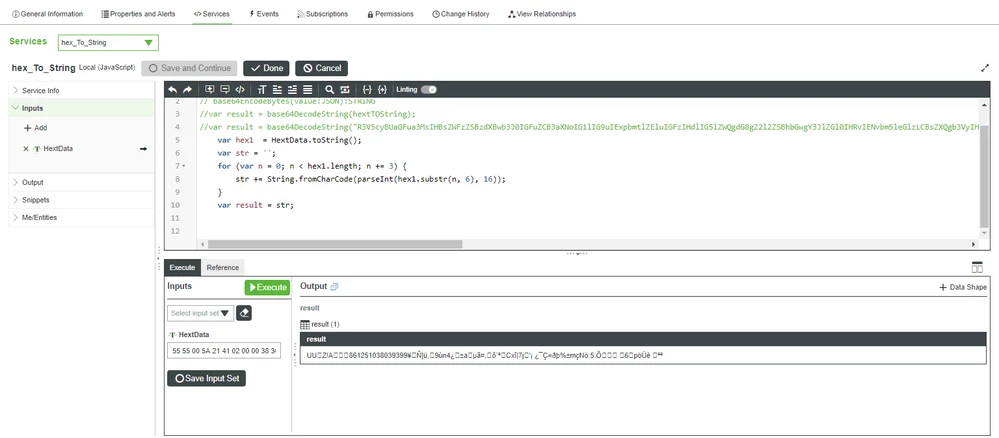

1. I'm using Thingworx 9.0, I want to show a dash or CCTV  camera on the thingworx mashup how can I do that, suggest any architecture diagram to show a dash or CCTV camera on the mashup.
2. I have sensor data in hex format which is in the attachment, I want to convert it in the readable format in thingworx how can I do that. I did with the below program but it will give me different outputs.
 var hex1 = HextData.toString();
	var str = '';
	for (var n = 0; n < hex1.length; n += 3) {
		str += String.fromCharCode(parseInt(hex1.substr(n, 6), 16));
	var result = str;
please suggest the way, thanks in advance

Thanks for reply.
There is one OBD device which support TCP IP protocol and they are sending
us data to MQTT payload in HEXT format.
We received the data on our MQTT server but can not convert it into
readable format that what I am asking for.
Secondly i am asking different question is that I want to display live dash
camera streaming in thingworx mashup.
Dash camera(don't know which protocol is supporting-its client
requirements) is sending data to its server personally we have to only get
this data from that server and display on mashup, that's is my question how
we can display live dash camera streaming on mashup.
