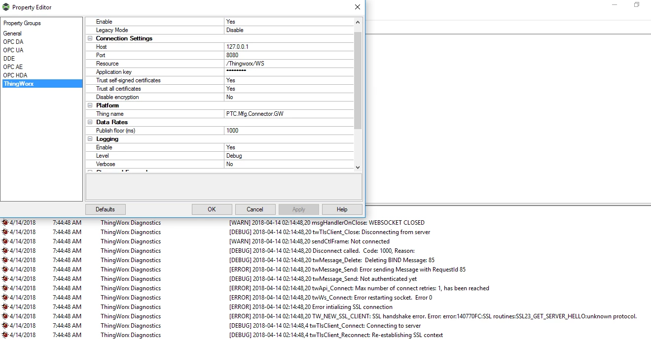

I have installed tx 8.2 and Industrial connectivity 8. I have configured all pertain to tx in Industrial connectvity project properties but still Im getting some issues with WS connection. Can anyone face the similar issue? Pl help me to sort this out.

Can you try to disable encryption value to 'yes' and check ?

Can you try making disable encryption to "Yes" in properties of thingworx in kepware console ?

Appreciate your response.. It works.. Thanks!
