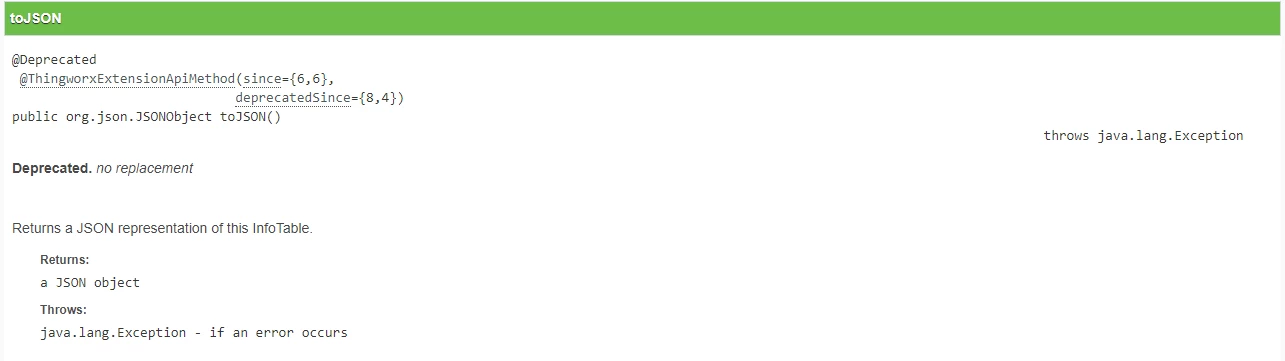

How to convert Infotable into JSON in Java Extension
How i can convert Infotable into JSON?
Since toJSON() function Deprecated. no replacement
@Deprecated
 @ThingworxExtensionApiMethod(since={6,6},
 deprecatedSince={8,4})
public org.json.JSONObject toJSON() throws java.lang.Exception
Any other methods available?

Hi @SathishkumarC.
This article may provide some guidance even though it relates to a service.
Regards.
--Sharon
July 25, 2020
Thank you for reply.
I know this with Thingworx. But the same thing I am trying to use in Java extension it was telling "Deprecated". If I am continue to using the same method will I face any issue in future?
