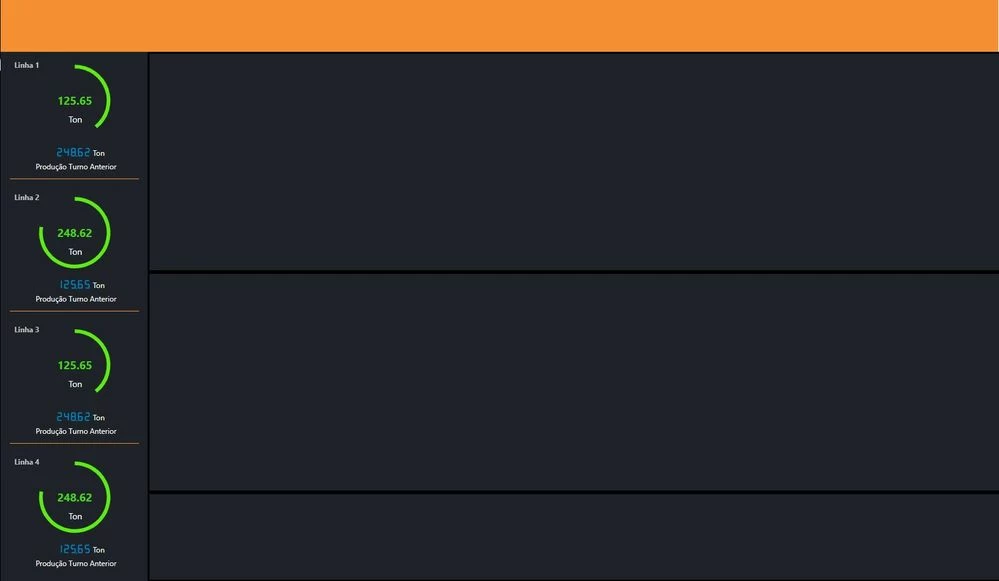

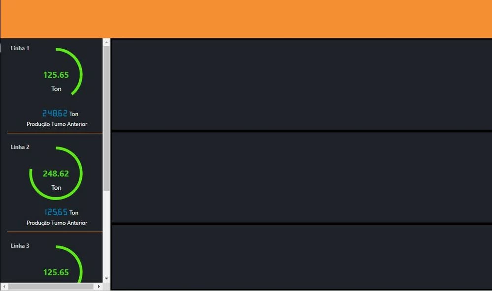

Currently I am working with a new responsive (advanced) mashup because I want to create a responsive dashboard.
In this case, I have two monitors. One with the resolution 1920 x 1080 (20") and other is the notebook with the resolution 1366 x 768 (14").
However, there are widget that does not responsive, so I need put on in front the widget panel and when I to run the mashup and change the monitor the widgets (that does not responsive) widgets don't look right on screen.
I am going to let the mashup's print below to facilitate understanding.
My question is: Is possible to create widgets responsives? If yes, how?

If you wish to make the gauge responsive, you would need to create your own widget using the original as a starting point.  Here's another community post that may be helpful.
Here's a link to a guide for creating your own extension.

For example:
I am using a "progressive gauge" but this widget is static.
Is there any way that I can make it responsive?

Most of the widgets (including standard Gauge) resize automatically when you put them inside responsive containers.
Can you draw a simple mockup, please? It will make it easier to understand what exactly you want to achieve.
