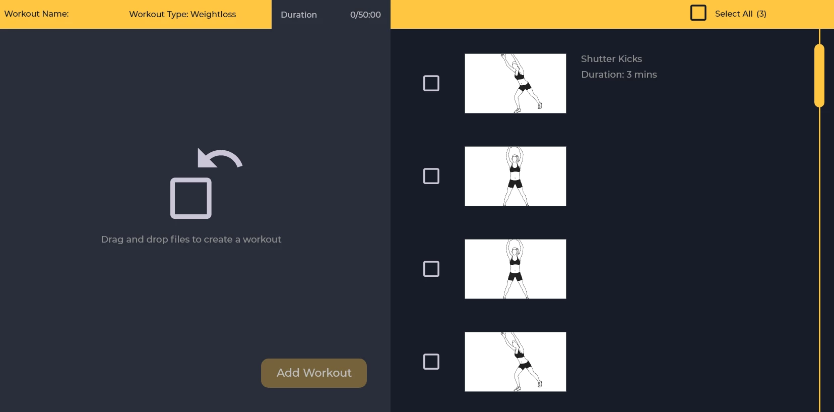

I want to make a drag n drop mashup which having workout video data which is in the collection list and want to drag that each data into left side container so that i have to make data list of video of workout.
See the above image i want to make the mashup same.

The unofficial Collection View has Drag&Drop features : https://github.com/BogdanMihaiciuc/BMCollectionView it's the father of the standard Collection View.
Carles.
