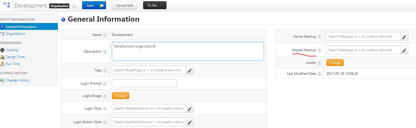

I want to create UI for using mobile(phone or pad) on the thingworx composer.
I believe that one responsive Application UI will work well on desktop or mobile, but there seems to be a way to make it only for mobile purposes.

Hello Yong June,
A responsive mashup that can work well in computer screen will look strange in Mobile devices.
Just create static Mashup in the size of a general smart phone, and bind the mashup to here
And when you login through FormLogin page, the mashup will be loaded regarding to the Screen resolution
