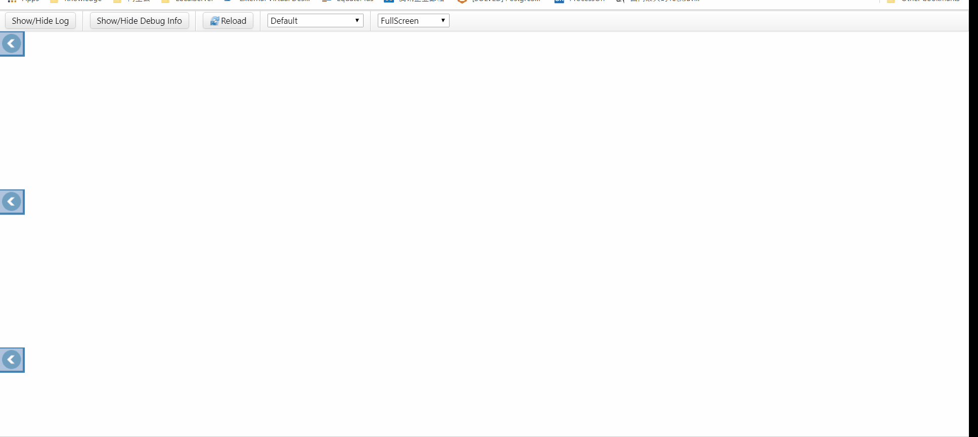

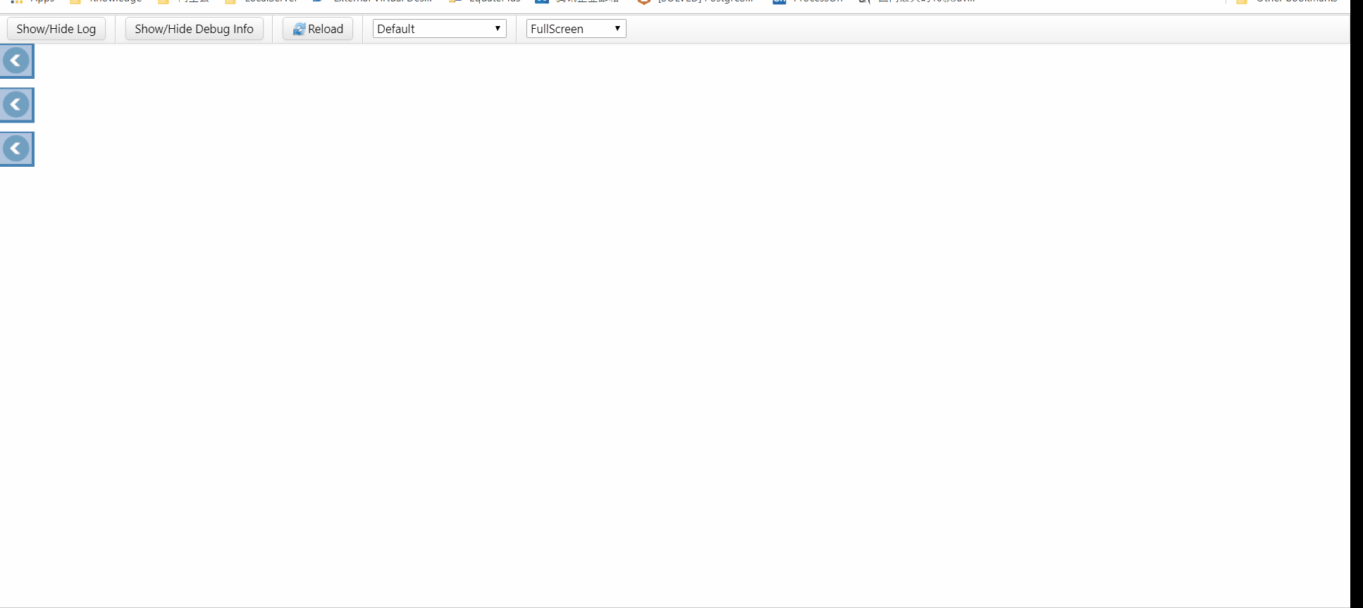

How to create multiple ExpandCollapseTabs ?
For a header or footer in the layout widget, if mark "ShowExpandCollapseTabs" then the header/footer can be expanded or collapsed , and the remain area in the web page can be adjusted automatically.
But how to create multiple ExpandCollapseTabs  like the attached picture ?   The Folder Pannel cannot get this as it won't adjust the size of the remain area when expanding or collapsing.

April 19, 2019
@posipova
The collection won't helpful on it ( at least I didn't find a solution with collection ) ,  the remaining page area won't be adjusted automatically.   For the attached file expandCollapse2.gif,  the expanded area overlap with next area , instead of moving the next area to lower position, like the behavior in header or footer in layout.
