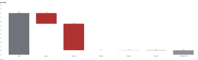

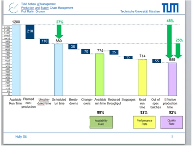

I really would like to have view like OEE Bridge.
I was trying to use Waterfall widget but finall resuld doesn t looks like OEE bridge.
Can I find any custom widget to handle this problem?
I would like have something like this
but I have like this one
I set up Total like ShowTotal : true and Effecitve time looks like that:
Category: 'Effective Time', // STRING
Amount: undefined ,
ShowTotal: false// STRING

I would like it to look like I have total as 100% and the rest of the values ​​show how much of that 100% was used by which category.

Hello @JK_10565232 ,
I took a look at the issue and created my own test data. There are some problems but is this what you are going for?
Here is the test data I was providing:
const InputData = new Array(
   ["Availble", 1200, 0, 0, 0, 0, 0, 0, 0, 0, 0, 0, false, false],
   ["Planned Non", -210, 0, 0, 0, 0, 0, 0, 0, 0, 0, 0, false, false],
   ["Unscheduled", -110, 0, 0, 0, 0, 0, 0, 0, 0, 0, 0, false, false],
   ["Scheduled",    null,  0, 0, 0, 0, 0, 0, 0, 0, 0, 0, false, false],
   ["Breakdown",   -36, 0, 0, 0, 0, 0, 0, 0, 0, 0, 0, false, false],
   ["ChangeOver",  -70, 0, 0, 0, 0, 0, 0, 0, 0, 0, 0, false, false],
   ["Available Run", null, 0, 0, 0, 0, 0, 0, 0, 0, 0, 0, false, false],
   ["Reduced",        -25,  0, 0, 0, 0, 0, 0, 0, 0, 0, 0, false, false],
   ["Stopages",       -35,  0, 0, 0, 0, 0, 0, 0, 0, 0, 0, false, false] ,
   ["Used",    null, 0, 0, 0, 0, 0, 0, 0, 0, 0, 0, false, false],
   ["OutOFSpec", -55, 0, 0, 0, 0, 0, 0, 0, 0, 0, 0, false, false],
  ["EffectiveProduction", null, 0, 0, 0, 0, 0, 0, 0, 0, 0, 0, false, false]
Let me know
