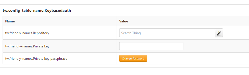

Could anyone help us, We want to use SFTP while configuring it we found below section
How to create thing for tw.friendly-names.Repository? Please tell us paths that are to be given in that thing and where and how?

    Hey Anil,
    Authentication to the SFTP server can be done two different ways: using a password, or using a private key.
    The fields in your screenshot are for configuring the private key auth. For that to work, you need to create a local repository thing, and upload the key in there.
