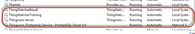

Hi all, I was wondering if any of you had examples of how to create the thingwatcher etc as a windows service.
Like this?
