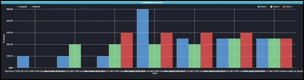

Hi everyone.
I am using the Custom Chart Widgets v3.0.1 from marketplace.
I would like to change the date format.
In the moment the date is like:
Você pode observar que a data esta muito longa. Quero um formato simples (MM / DD / AAAA)
22-Sapphire I
April 1, 2020
Easiest would be to format it before returning it to the mashup in your service.
you can also take a look at the localization tag which i believe determines date formatting to an extend.
Maybe even the chart x-axis format itself? I don't think it has this, but just wondering, since Grid would have it.
April 2, 2020
Hi @PaiChung
I'm sorry, but how to find the "localization tag"?
22-Sapphire I
April 2, 2020
There should be something like: dateTimeFormat_Default
In the localization tables
April 2, 2020
In Timeseries Chart we have XAxisFormat that you can change the timestamp format you want to present
In Bar Chart, there is only a LabelAngle that allows you to have more space for the time property.
While if you use Label chart - Bar style, set
XAxisField - time property;
XAxisLabelType - Date/Time;
XAxisFormat - dd-MM hh:mm  or other style
You can have the right chart you want.
