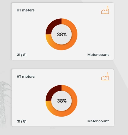

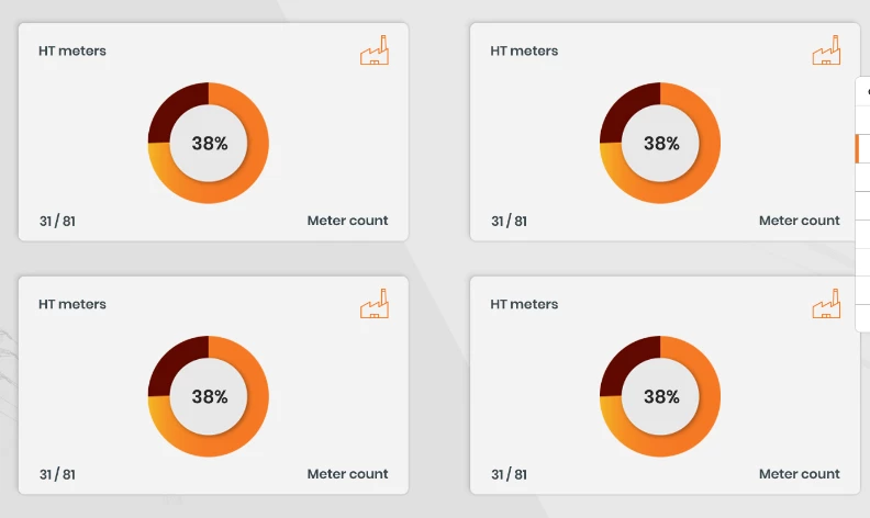

Please fine the attachment. This is an Actual OutputActual OutputExpected OutputExpected Outputexpected Sample.
I have created infotable with values called in a service and bounded to the collection widget. Now I'm able to see all cells but one cell in a row.

That behavior should be driven by the resolution of the screen.
if you zoom in or out in the browser do you see a rearrangement happening?
