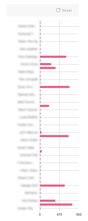

In TWX 9.5, the x-axis is not displaying all values.  It seems to be skipping every other value.  I'd like for it to display all values.  I did not see a setting for this in the bar chart configuration.  Is there a way to display all values?
August 29, 2024
@Willie unfortunately bar chart widget automatically controls axis values displaying and does not allow user config.
to view more values, you can zoom out mashup view page so x-axis shows more numbers with smaller interval.
