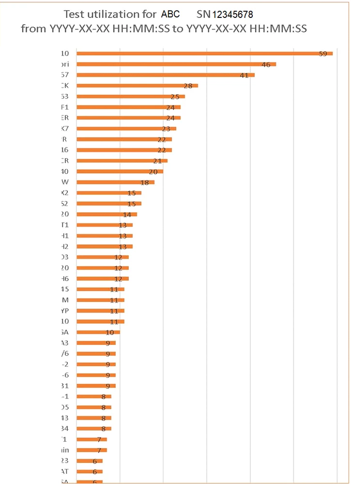

I need a bar chart to display bars by ascending/descending values.  The values fluctuate so I can't set the bars in static order.
Is it possible to get the bar chart widget to display the bars by ascending/descending values?
I looked at the widget properties, but I didn't see an option to set this.
Please see the following example from MS Excel:

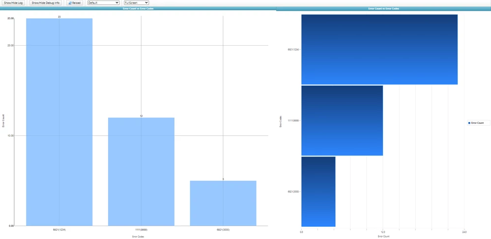

I was able to figure it out after my earlier post.  Instead of setting many data fields, I set only 1 data field.  This way, I can sort the data in my service.  When I use the label widget, I'm unable to display the value on top of the bar.  Is there a property in the label widget to set this?  I was unable to find this setting.  Also, is there a way to remove the decimal places in the y-axis and grid in bar chart widget?
Please see the charts below.  The label widget is on the right.  Bar char widget is on the left.

@Willie ,
Can't you just perform a sort on your infotable before it is returned to the mashup?
Willie16-PearlAuthorAnswer
September 15, 2020
September 15, 2020
For the bar chart, I actually had to modify the widget code to change the number of decimal places.  If you look in barChart.runtime.js, you'll find this line:
chart.yAxis.tickFormat(d3.format('.02f'))
Just change that to your desired format, or if you want it to be flexible, create another widget property and tie it to that format.
