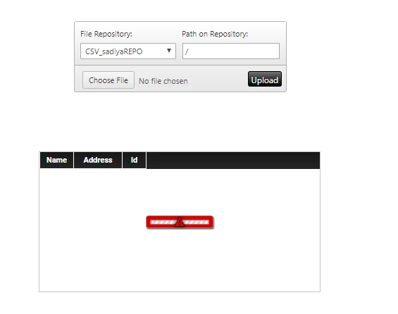

i have used a file upload widget and upload a .csv file but i'm unable to display the data in a grid.
unable to write the exact service.

If you know the structure of the csv file before hand, you can use the CSVParser extension .
Create a service similar to
var params = {
path: fileName /* STRING */,
columnMappings: 'Name;Address;Id' /* STRING */,
hasHeader: true /* BOOLEAN */,
fileRepository: "SystemRepository" /* THINGNAME */,
fieldDelimiter: "," /* STRING */,
dataShape: "ImportUsers" /* DATASHAPENAME */
// result: INFOTABLE
var result = Resources["CSVParserFunctions"].ReadCSVFile(params);
The ImportUsers datashape will have the 3 fields  Name;Address; Id.
Then set the FileUpload widget FileUploadComplete event to trigger the service.
Map the all Data return value of the service to the grid.
Hope this helps
Christophe
