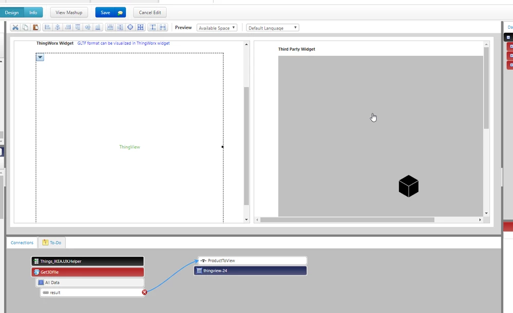

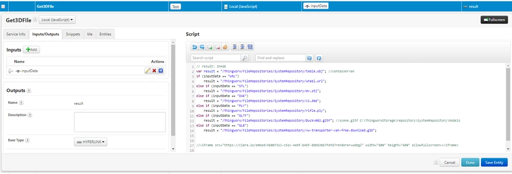

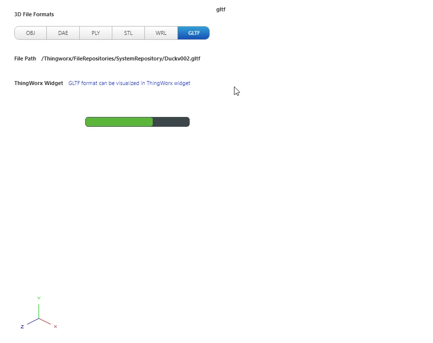

No messages in logs or errors. I have included the screenshots and piece of code used to display GLTF 3D model in ThingView Widget.

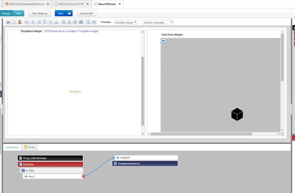

3D model files are placed in system repository and loaded via service.please find the screenshots for reference.
OBJ 3D models are displayed via threemodelviewer which is downloaded from PTC market place. This extension is not supporting GLTF thats why trying to load GLTF in ThingView widget. I have sample GLTF file used for this example with reply. Please help.
