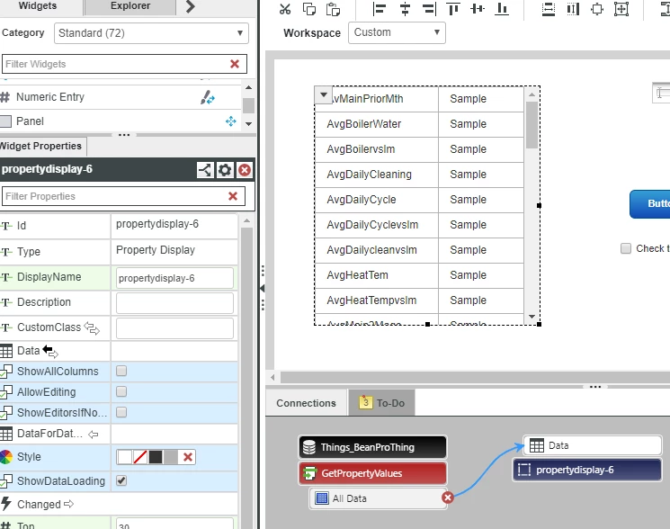

Tried using the Property Display Widget also but its displaying only 2 column grid of field name and value pairs. i wanted to design a grid with a 13 columns(a field name with 12 value pairs).
