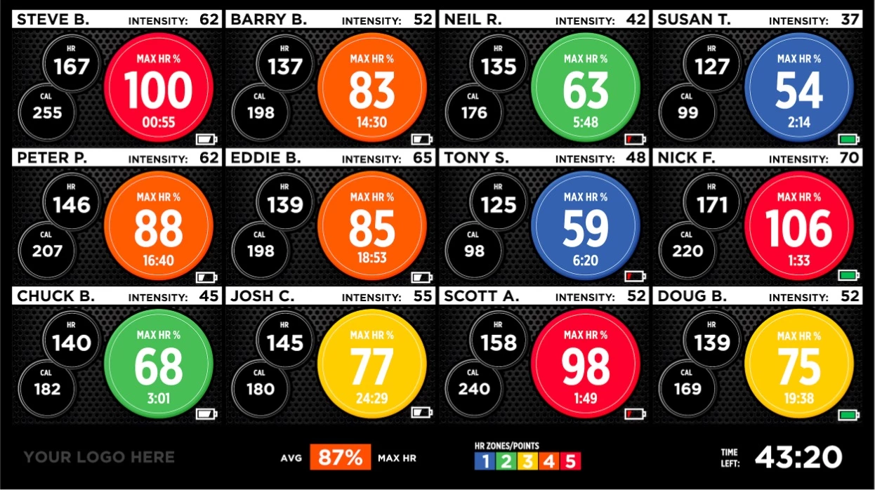

     I have  20 bands and assign that bands to 20 members and  getting live data in Thingworx with parameter name as Heart rate ,average and max HR .I want to display multiple members data  in collection widget please refer the below attachment and suggest :
1) how do I display multiple members live data in collection widget??
2) How to apply state formatting according to Max. heart rate levels ??
3) which widget is used for according to heart rate zones/Points how to apply state formatting to round shape Max  heart rate according to bellow dashboard???

Each band is presented in a small mashup with 3 gauge;
each row of infotable includes the data of a single client, bind this infotable to the collection widget;
Stateformating should be very self-explanatory, bind the HR data that will change to the state.
You can bind the stateformating in the Gauge, or a Shape widget, the Shape could be a circle
