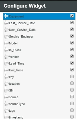

Can anyone advise any get around on the following.... in the Thingworx before 8.3/8.4. I am able to use Property display widget with Configure Widget function to select the field which i like to display and reorder in a table format in the mashup.
However, in Thingworx 8.5.4, the configure widget function is not available in the Property display widget, i am not able to select the field to display and in version 8.5.4. In addition, the Property value is hidden, and we need to click to pop up another window to see the value.
My mashup is intended as a report to show the value in a table.
Anyway i can get around, to select the data and reorder it? Did i used the wrong widget. Any guidance?

May 13, 2020
Hello Christophe,
the following is the data to display in the mashup, using the legacy property display
Select field to display and reorder with configure widget
If using the new  property display in  version 8.5.4, configure widget is not available.
I am also not sure it i had configure it correctly, but i am definitely not able to re-order and select data to display.

cmorfin19-TanzaniteAnswer
May 13, 2020
Thank you @newieKek  for those details.
I do understand better now.
You are right the Property Display widget does not allow this as yet.
As a workaround , as you have seen, you can use the Legacy Property Widget or possibly the Grid/Advanced Grid ones.
I have reported this to R&D , though that is likely to be considered an enhancement request: https://www.ptc.com/en/support/article/CS324951
