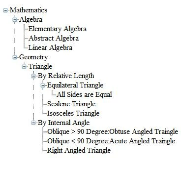

how to display the hierarchical data in form of tree in mashup
how to display the hierarchical data in form of tree in mashup as shown in the image.
Mar 13, 2018 1:10 PM UTC
Hi @achitters you can use Grid Advanced Widget from ThingWorx Marketplace. It contains both Grid&Tree widget allowing you to display such a hierarchy. Additionally there's a sample entity within the zip that you'll download named GridAdvancedExampleEntities-v3.0.xml this will create some demo mashups and things with services to return demo data something the attached screenshot

Mar 15, 2018 2:06 PM UTC
Thingworx has a structure called Networks which creates that hierarchy and can be easily visualized in the Tree widget in a mashup.
What it depends on is a table that has to and from or child and parent relationships.
for example
child   |   parent
    A    |
    1    |      A
    2    |      A
    B    |
    3    |      B
    4    |      B
This would give you two root nodes called A and B each with two children
The only requirement to be able to use a Network is that they all have to be Things, if that is not needed, you can create a DataTable instead. Make sure you have the Child and Parent field as primary in the DataShape.
