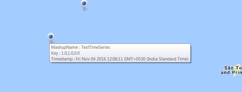

How to display the location of multiple objects on a google map and on clicking one object we get its location details.
we want to display the location of multiple objects on a google map at the same time and on clicking one marker we should get complete location details of that object.

Jan 20, 2017 8:20 AM UTC
Use Google Maps widget that's on the marketplace: https://marketplace.thingworx.com/Items/google-widgets
Jan 20, 2017 8:33 AM UTC
Hello Priyanshi Saxena​,
You can use Google Map widget. It's easy. Just need to pass an infotable with at least one Location type field to the Data field and then pick this field in the LocationField widget property. Don't forget to mark true ShowMarkers property (but don't worry, it's true by default).
Hope it helps, let me know if you need any additional questions.
J.
psaxena1-VisitorAuthor
Jan 30, 2017 11:08 AM UTC
Hi Jakub,
Yes it worked, I am able to display multiple locations but how to display the data associated with those locations in the infotable (i.e other fields in the infotable) on selecting any marker on the map.

Jan 30, 2017 12:32 PM UTC
Priyanshi Saxena​ I think you would require to use Tooltip option for that.
Jan 31, 2017 5:42 AM UTC
Hi Ankit,
Yes I have enabled the tooltip option but nothing shows.
Jan 31, 2017 6:55 AM UTC
Hi Priyanshi Saxena​,
It works fine for me. I passed all data (Location, Tooltip details) as data to Google Map. Then selected my LocationField and TooltipField properties from the dropdown and it shows data as expected.
What are the exact steps that you are following.
Ankit Gupta

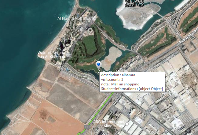

Jun 19, 2017 2:05 AM UTC
HI Jakub Kaczynski​, Hope you are doing well.I have question please.
i have used info-table to present multiple locations, each location point has some few properties that i could manage to show once the location point is clicked
Now, i need to present infotable as one of the data presented on each location point, so infotable within infotable, but actually data is shown in below format
it shows [object Object] instead of showing the content of info table, could you please assist
