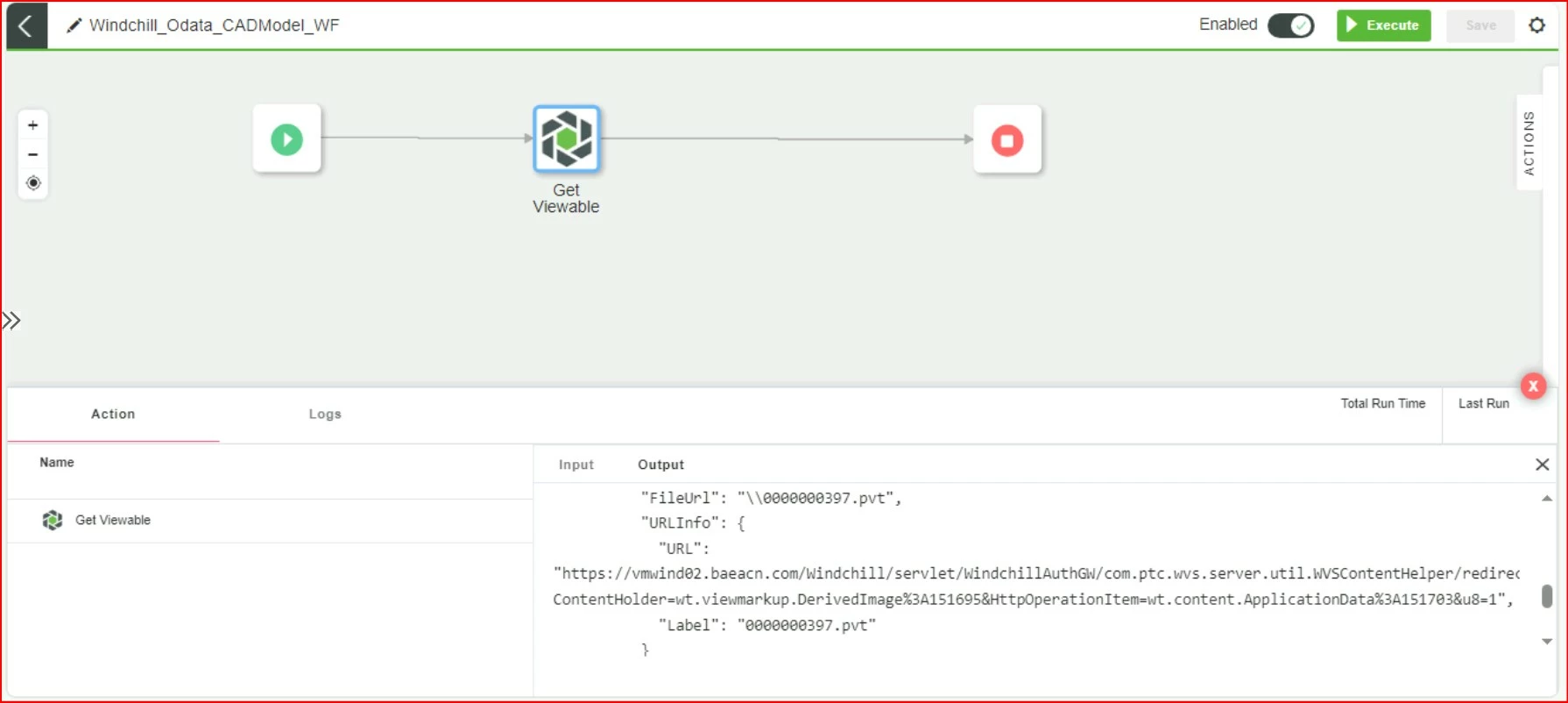

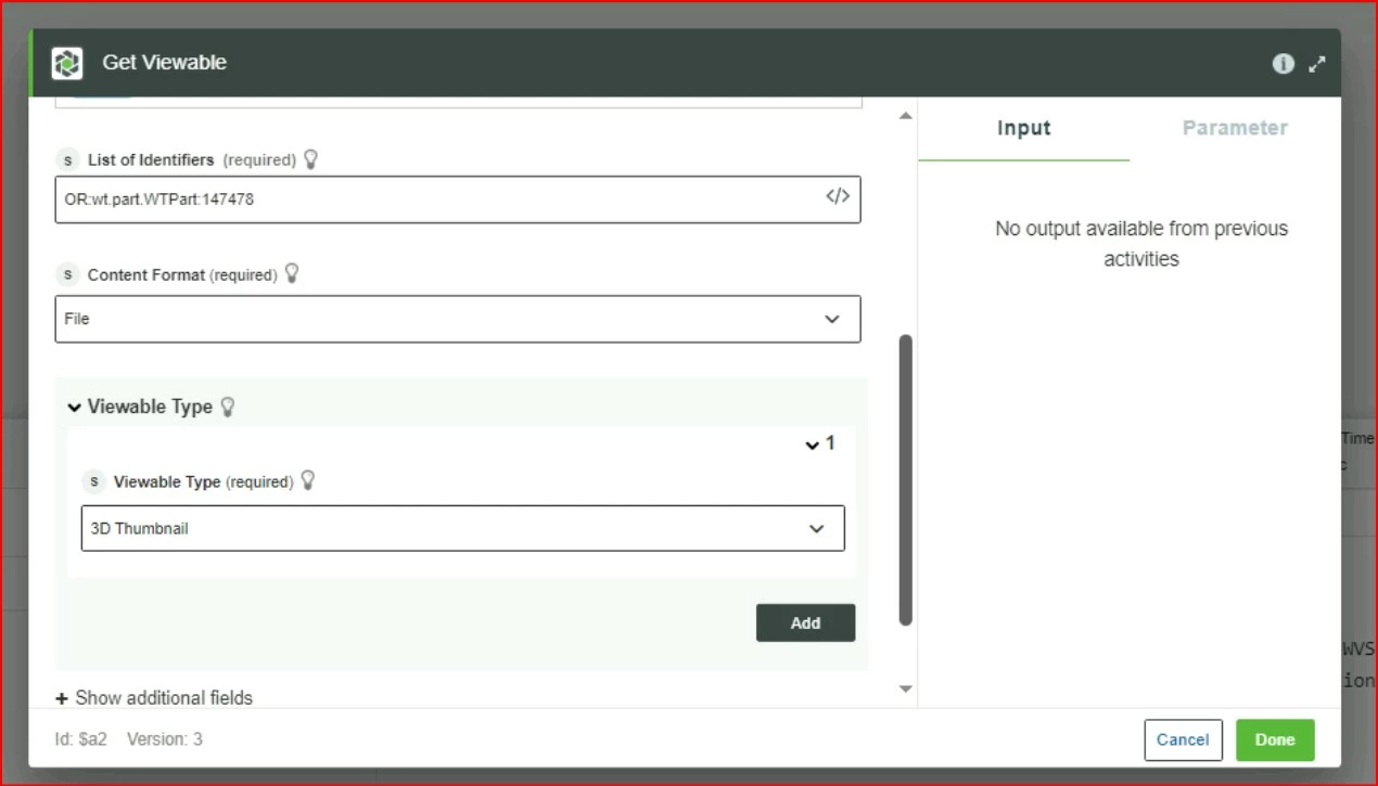

I have installed ThingWorx Flow and configured it with Windchill Server. For Testing purpose I tried creating a sample Workflow which will use GetViewables to retrieve windchill visualizations as 3D thumbnails.

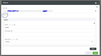

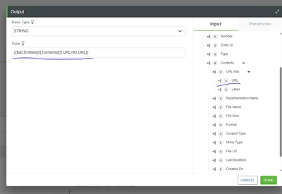

Disable Async in Workflow Webhook
Map URL to Workflow Output

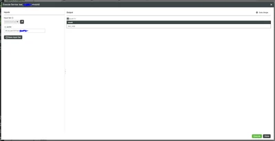

Open WorkFlow Thing in Composer. Navigate to service, you can find your workflow name as service. You can get the URL by executing the service.
Since I don't have a proper example in my test windchill. I have mapped the part name as output.

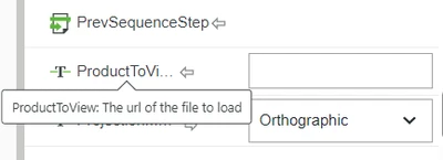

Hi @Siddharth_Jhs
You can map the URL to widget property "ProductToView"  to load the 3D Model

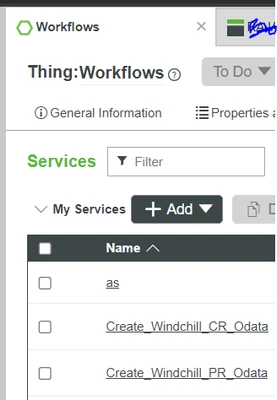

You can find all Thingworx Workflow as a Service in Workflows Thing
You can use those services to show data in Thingworx UI
/VR
