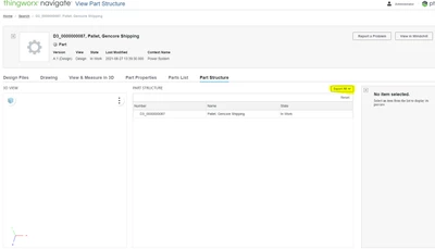

Thanks for the clarification, the other option available for downloading multiple files in a bundle would be to use the 'Export All' button that shows in the out of the box apps.  Here for example is the View Parts Property app:
For more info on which tasks will allow you to do this, see Overview of Out-of-the-Box Tasks (ptc.com) .  This link has a description of the functionality for all of the tasks.  These two options I have suggested are the only two available out of the box for downloading file bundles.
