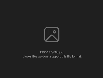

Thanks @Rocko,
I tried this out but when the file is downloaded from the repo it was saved to instead of an image the following is rendered:
I am using the TwoDThumbnailURL.URL value for the url parameter in LoadImage, this is an example:
https://<server>/Windchill/oauth/servlet/WindchillAuthGW/wt.fv.master.RedirectDownload/redirectDownload/DPP-1751421.jpg?u8&redirect=true&ContentHolder=wt.viewmarkup.DerivedImage%3A1302633096&HttpOperationItem=wt.content.ApplicationData%3A1302633103&forceDownload=true"
If I remove "oauth" and past in browser the image is downloaded and renders successfully.
Perhaps I need to further prep/modify the TwoDThumbnailURL.URL before running LoadImage?
Rocko
Oct 15, 2024 2:03 PM UTC
It looks like the URL you have does a redirect, since you are calling a Servlet on Windchill side. This is then interpreted by the browser, so you don't get the image directly.
You can check the downloaded broken image and open it in a text editor to see what the LoadImage received.
You can also try to download the image from your browser and then use Developer Tools (F12) or Copy Download link from the browser's "Downloads" button to see what is the correct URL.
You might have to do a Resources["ContentLoaderFunctions"].GetText first, read the result and get the final URL from there.

mariaSutton12-AmethystAuthorAnswer
Dec 2, 2024 1:28 PM UTC
The solution provided by the PTC Cloud team for this issue was to use MediaEntities["your-integration-odata-connector-with-sso-here].StreamFileRepository
The relativeURL parameter should be modified to start at "/Windchill..."
This function will download the image using your SSO configuration and add the downloaded file to your choice of Thingworx Repo.
