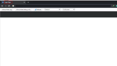

How to dynamically change Title of Master Mashup
Is it possible to update the Title of a Master Mashup dynamically?
Thanks in advance

We have already tired the a solution which was mentioned earlier. link which we followed - https://community.ptc.com/t5/ThingWorx-Developers/how-to-make-make-a-variable-title-for-a-Master-Mashup-in/m-p/587438 This didnt work out when we tried this. @CarlesColl and @vguevaraperez

The solution mentioned in the article did not work for me. Can you provide a bit more clarification on that solution? I need the variable to be changed run time.
