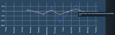

May 3, 2023 4:17 AM UTC
Hi @slangley
I used Line chart widget to show multiple line data. I used multiple data source to construct each line graph.
I want to customize the tool tip value for each line (along with the default series data, I would like to add few more additional values coming from the same data source field, Ex: Sat Apr 29 2023; Power: 21; Consumption: 10).
for single line graph I can be able to achieve it by using "${DataSourceN:<Infotable-field>} " command. But for the multiple line chart, I don't know how to do this.
Regards
Sugumar Ramasamy
