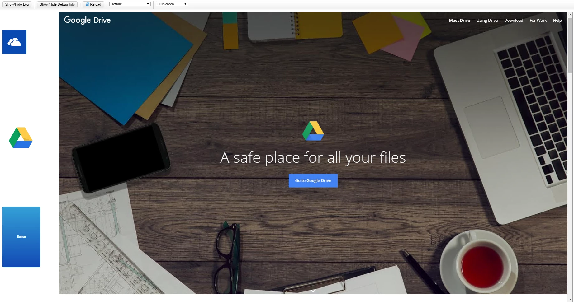

i need to embed the Google Drive or One Drive's UI in a mashup, in this way ( expected.png )
I know the existance of the relatives APIs for this, but i would like to use also the UI.
If i link directly the URL into my WebFrame, it gives me back a "refused to connect" when i try to login. ( error.png )

Ok, I just found a workaround, but it works just for Chrome users, since it's based on a Web Extension for Chrome: Ignore X-Frame-Headers
Now you can paste your Drive Link as it's shown on your Browser url bar.
On the first time, Drive will ask to validate the "new device" with the 2-steps access.
Hope it helps! 😄

As far as I understand from google search:
You get in the console something like "Refused to display 'https://www.google.com/' in a frame because it set 'X-Frame-Options' to 'sameorigin'."
This is an iframe specific functionality.
You can see some explanations here:
https://stackoverflow.com/questions/8700636/how-to-show-google-com-in-an-iframe
https://stackoverflow.com/questions/20681974/how-to-embed-a-google-drive-folder-in-a-website
