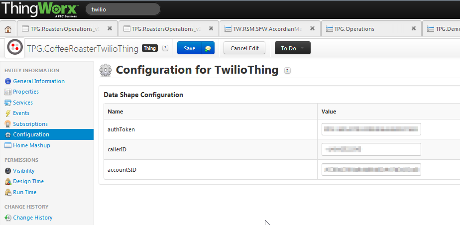

First, you'll need to create a developer account over at Twilio. Twilio is a service that will send voice and SMS messages for you, using simple REST calls. Then, you'll need to go to the ThingWorx Marketplace and get the Twilio extension.
Once you've imported the Twilio extension, you'll need to create a Thing based on the Twilio ThingTemplate, and configure it with your Twilio account details. The extension comes with instructions. Here's a screen shot of my configuration:

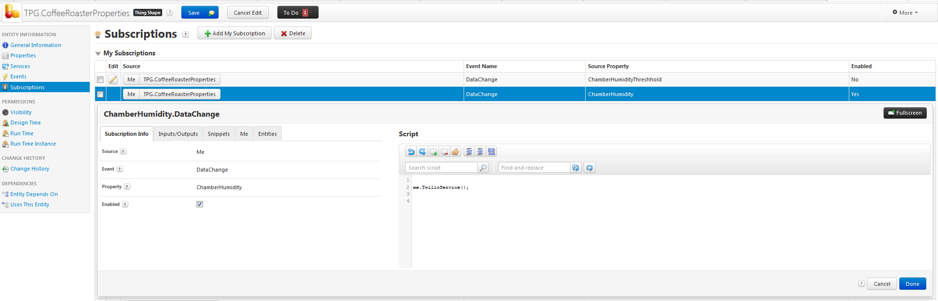

In our scenario, we're going to monitor a coffee roaster for a high humidity condition. Our Thing Model has coffee roasters with ChamberHumidity and ChamberHumidityThreshold properties. We want to send a voice message to the human running the roaster when ChamberHumidity is greater than ChamberHumidityThreshold. In the ThingShape that defines all my roaster properties, I subscribe to the DataChange event for the ChamberHumidity property:
Note - I'm subscribing to the DataChange event of the ChamberHumidity property, and then letting my service check the condition, instead of subscribing to an alert on a property, subscribing to that alert, and then running custom code. As with most things, there's more than one way to do it (TMTOWTDI).
The subscription does one thing; it runs a service called TwilioService. TwilioService checks to see if ChamberHumidity is greater than ChamberHumidityThreshold. If it is, I use my Twilio Thing's SendVoiceMessage service to send a push voice message. If it's not, I just make sure my ChamberHumidtyAlarm property is set to false:

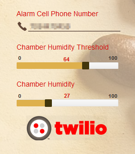

Once we built all the infrastructure described above, we built a mashup so we could set the properties and send push notifications in real time:
