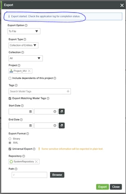

Hi @S_Elsayed

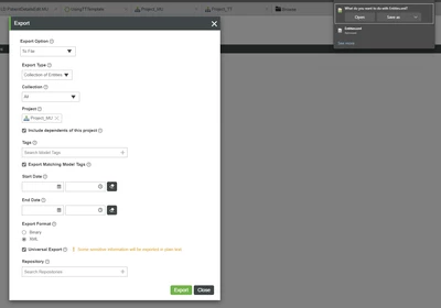

Yeah, when you export a project without a repository, the file will be downloaded locally.
But when you specify Repository, entities will be exported on the server side
You can find exported entities in the Repository and you can download it
/VR

Hi @S_Elsayed
If ThingTemplates are part of another project, you can import them in Prod (If any changes are done to ThingTemplate) and then your project. Also if some changes are done on ThingTemplate and nothing changed on your project, you can import ThingTemplate Project alone.
Also while exporting make sure to check  which will include dependent entities along with your project

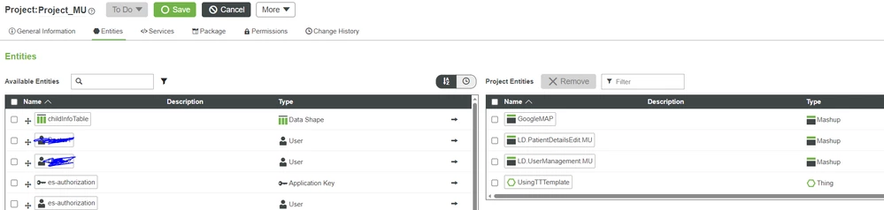

For example: I have project Project_MU which has some mashups and Thing (which uses Thing Template from Project_TT)
Also, Mashups uses Things that are from another project. So while exporting when we check Include Dependents of this Project all dependent entities will be exported.

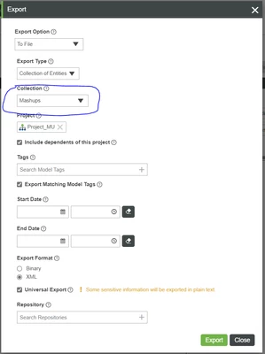

In some cases, if you made changes only to mashups not to Things or ThingTemplate you can export only Mashups from Test env
Export Format: XML which can be modified out of Thingworx. Export will be a normal XML which can be altered without Thingworx Composer (which is not recommended :p)
Universal Export: Sensitive information like passwords will be decoded while exporting. So entities with sensitive information can be imported into another system without any issue.
If possible make your project as Thingworx Extension and import it into the Production environment which will prevent altering codes directly in the Production Environment. You can use Thingworx Solution Central to deploy into different env or you can create Thingworx Extension manually

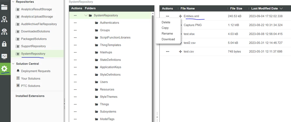

S_Elsayed7-BedrockAuthor
7-Bedrock
September 4, 2023
Thank you so much for your response.
I thought when exporting, a file will be downloaded locally on PC, however apparently that is not the case.

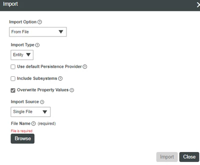

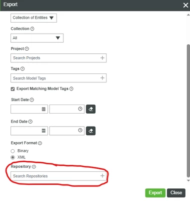

I figured it has something to do with "Repository". Could you tell me how I can retrieve the file/folder exported so that I can import it?
There are these options for importing, but I don't know of these is suitable considering the project i want to export is on another server.
Velkumar19-TanzaniteAnswer
September 4, 2023
Hi @S_Elsayed
/VR
