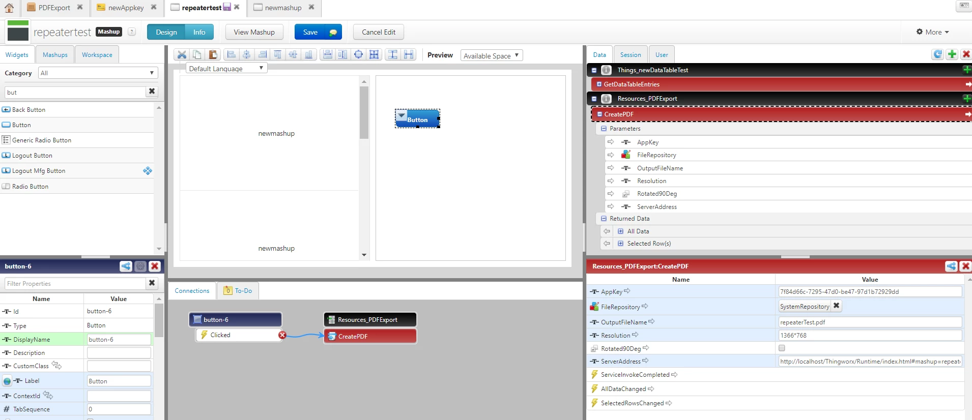

@Sheetal_sable : what you can do is to have a button widget on mashup and use click event to call CreatePDF service coming from Resource_PDFExport
attached is the screenshot showing the mapping of parameters for createPDF service. you can directly put down the parameters at mashup level as shown in screenshot
like in my ex

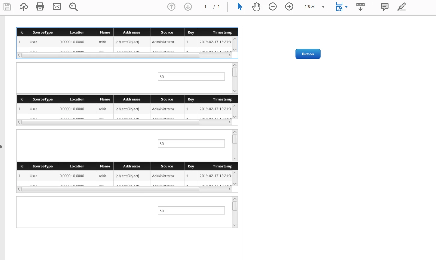

my mashup shows data in grid, having textbox that is dragged to repeater widget.
if this resolves your problem then mark this as solution for documentation and benefits for others
