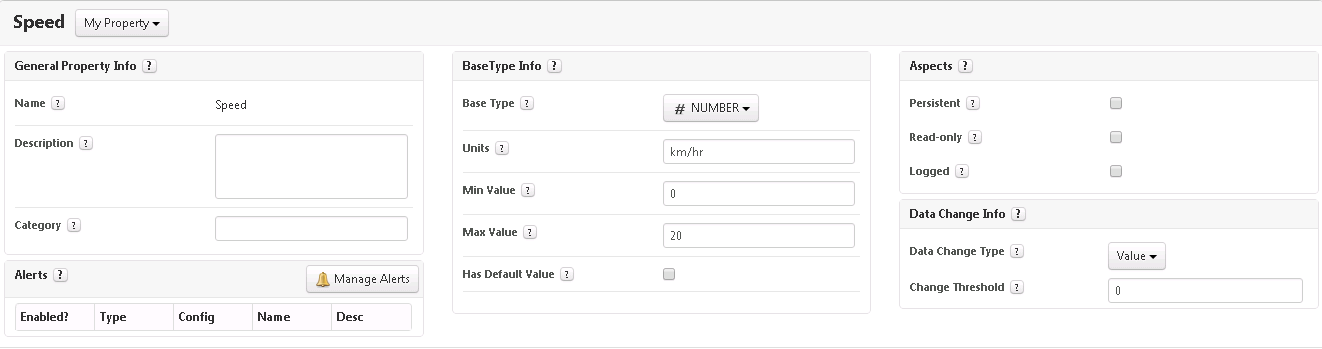

I have a property for a Thing "WeatherRover" which has a property "Speed". While creating "Speed" property, i mentioned following BaseType info,
Base Type: Number
Units: km/hr
Min Value: 0
Max Value: 20
Now I want to use this Base Type info on the mashup i.e. Units, Min Value and Max Value. How to get this BaseType information provided for each property? I tried using "GetPropertyDefinition" Service, but it doesn't gives all the info needed.
