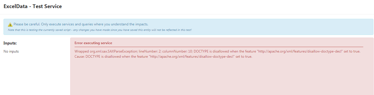

I am facing a problem which is while using that GetXML() snippet and giving the URL of the Google Sheet in its params,
I am getting this:
Now can u please help me out with this.
I tried to resolve but did not found any solution.
Thanks.

Yeah, I see the same issue for me. I have tried using the GetJSON() service & it seems a bit happier.
I think what we may need is here: https://developers.google.com/drive/v3/reference/files/export#try-it
We can use the export request to get the content of the file. The fileId and the mimeType are needed as the request parameters: have a look here for the mimeType Supported MIME Types  |  Drive REST API       |  Google Developers
We should be able to get the content this way, into ThingWorx.
