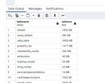

We have a ThingWorx instance that has been running for the last 4 years. In the database, streams have consumed 1 TB of data. Is there a way to find out exactly which stream has consumed the most space in the database?

How about naive approaches? They might take a while to run though...
select entity_id,count(*) from stream group by entity_id;
select entity_id,sum(pg_column_size(field_values)) from stream group by entity_id;

Aug 12, 2025 11:49 AM UTC
The caveat being it may not directly reflect disk space due to how the DB organizes its tables, blocks, dead tuples and so on, but it should give an indication on the worst offenders.
