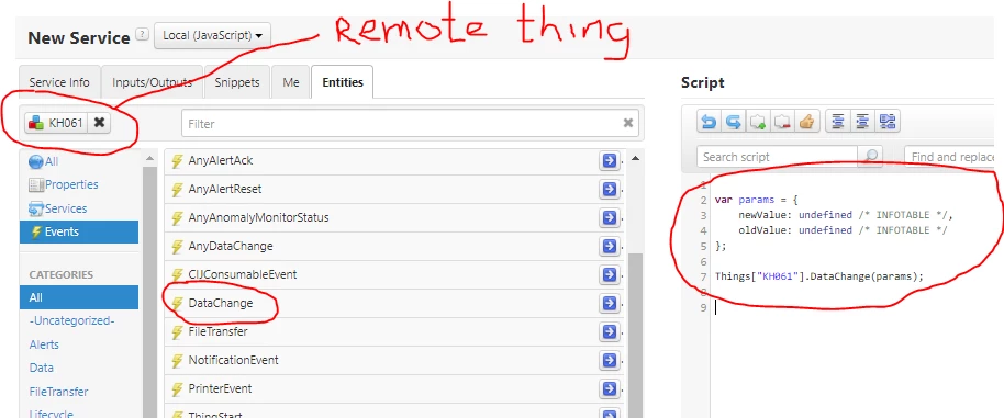

as part of my testing I am trying to generate a property change on a property that has a remote binding to a property on a remote thing. Because the property is remotely bound I am unable to set it via the composer.
I have a test utility thing and was hoping to create a service that would generate a server side property change event (I have successfully done this for remote thing events previously). I see that there is the option, but I'm unsure how to use it. I have selected a remote thing and inserted the DataChange event into my service, but there doesn't seem to be any way to set the property name.
I have selected a remote thing (KH061) and inserted the DataChange event into my service, but there doesn't seem to be any way to set the property name.
var params = {
newValue: undefined /* INFOTABLE */,
oldValue: undefined /* INFOTABLE */
Things["KH061"].DataChange(params);

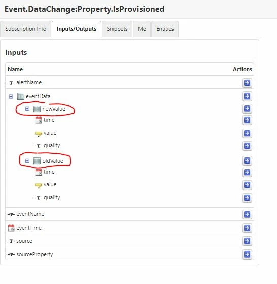

Presumably the 2 infotables (attached file) match the ones you see when subscribing to a property change? If so is there a defined datashape for that? Also not sure what value toset the Quality parameter to.
How would you set the property name?

thanks for the reply. Sorry it wasn't clear.
I am familiar with the edge server etc. but I'm looking to to mimic a remote property push from the server side.
This is for test purposes only, so that I can test my subscription code without involving a real remote device. The particular scenario I wish to test is difficult to actually replicate on a real device.
I have done something similar in the past but with remote events (faults & warnings). I have a test utility thing where I added service  that generates a remote event but it is all done on the server, using snippets on a remote entity's event.
I'm looking to do the same thing for a remote property change. I can see that I can choose a remote entity's data change event from the snippets, but can't see how to configure it for a particular property. It just seems to take 2 infotables as inputs (which appear to be new & old value) but there isn't anything that allows you to say which property the data change event is for.
hope that makes a bit more sense.

You can't, at least from Server Side Javascript (I don't know if you can do it with a Java extension...). I know it's not the solution, but actually we rely on AnyDataChange not DataChange, and you can simulate AnyDataChange event without problem.
