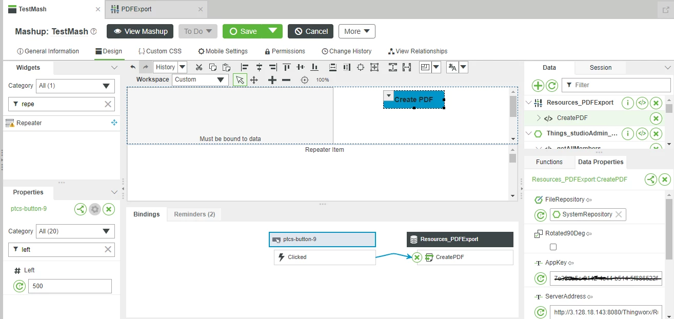

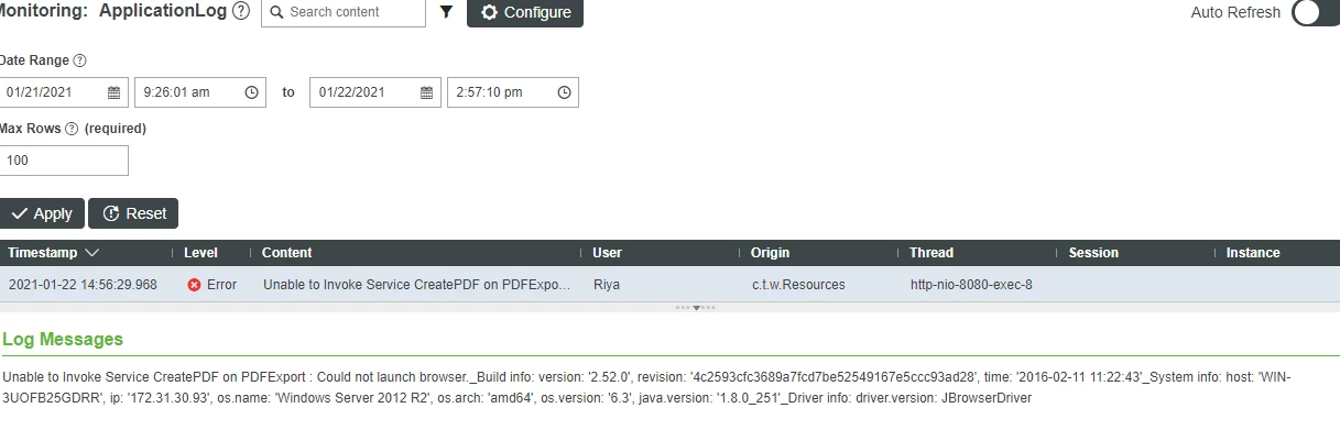

          I'm using Thingworx 9.0 version and I want to generate pdf file. I'll refer this post and I import an pdf extension in Thingworx and follow all steps with give an all inputs to parameter But I'm getting an error ,when I click on button. I'll search on this error and refer this post but it is not working so Please refer the below attachment and suggest
1) How Do I generate pdf and excel file when I click on create PDF button??  OR
2) Is their another way to generate pdf file by taking screenshot of any mashup and generating an pdf or excel file
Thanks in advance

Hi @RM12.
The PDF extension that was previously found on the Marketplace is not compatible with 9.0.  Currently there is no option to generate PDF files in ThingWorx.  However, there are requests for this on the ThingWorx Ideas forum.  I encourage you to vote for these to improve the possibility they will be included in future releases.
For Excel, you can install the CSV Parser extension available on the PTC Download page:
Regards.
--Sharon
