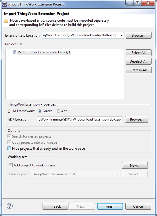

For my first test, I would like to be able to export a file from Eclipse and import it in ThingWorx Composer as an extension. I chose to take an existing extension project (RadioButton) and to export it without modifying it. Thus, I will be able to have a clean project for my first test. As far as I understood, the export must be in a ZIP format. However, I can't manage to create it.

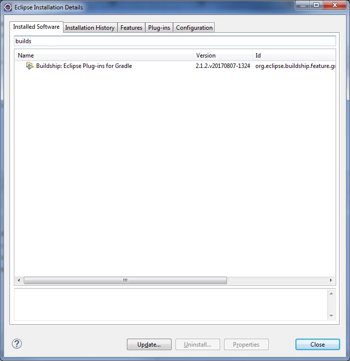

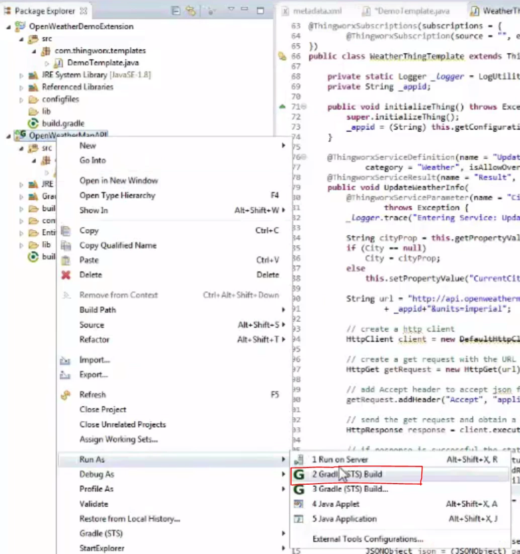

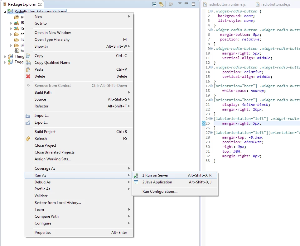

Following the video tutorial, I created the extension project using the parameters shown in the "Import Project RadioButton MyEclipse.png" file attached, with Gradle build and the latest Eclipse SDK. In the video tutorial, they are then able, by right-clicking on the project folder, to "Run as -> Gradle (STS) Build", as shown in the "Gradle STS Build Tutorial.png" attached file. In my Eclipse project, however, I don't have this option, as shown in the "Gradle STS Build MyEclipse.png" attached file. I tried to install the Gradle Build Eclipse plugin, shown in the "Installed softwares MyEclipse.png" attached file, but it did not help.

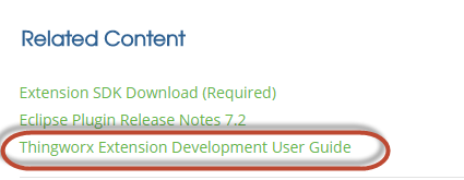

Hi Antonie, depending what build platform you are using i.e. Gradle or Ant you'll need to navigate to the build.gradle file in your eclipse project right click it and run as gradle build (if building with Gradle) else run as ant build
I believe this covered in detail on page 52 of Extension Development Guide under the topic Building Extensions you can download this guide from the ThingWorx Marketplace - search for Eclipse Plugin for ThingWorx Extensions and refer to the Related Content.
