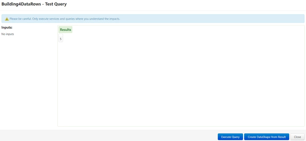

I am using a SQL query that looks something like this:
SELECT COUNT(*) FROM Location
When I test it, I get the following:
Capture.PNGHow do I get that as an integer datatype? Because I need to bind this value to a label widget or any widget that displays values.
I have tried changing the output basetype to integer and it still does not work.

Can you try wrapping that service in another service and extract the result?

Could you please clarify what error you are getting when you set it as an integer or number?
What is the output type in the screenshot you provided?

When I set it as an integer, it does not give me any errors, it just gives me the same result that is shown in the picture. (but, when I set it as an integer and save it, I see that the output basetype keeps going back to an infotable, which makes me think that this SQL query does not allow integer outputs) The output type in the screenshot I provided is supposed to be an infotable, but there is no columns.
