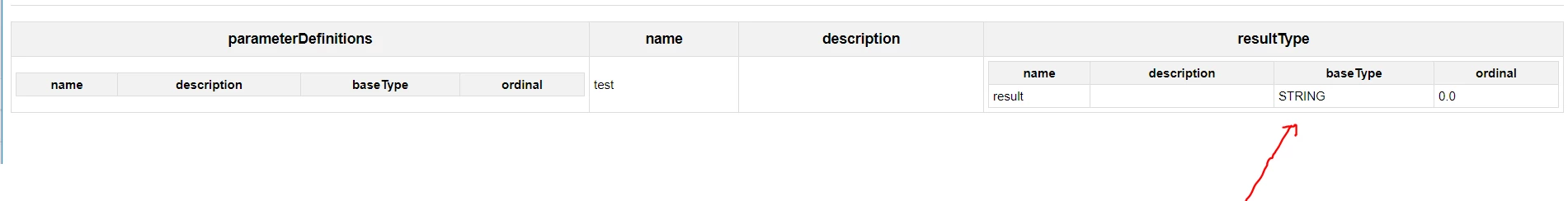

I created custom service to fetch InfoTable data through Rest API and tried converting the output of the INFOTABLE using INFOTABLE.toJSON() function and set the output parameter accordingly but while I am trying to access it using rest API I am not getting the output in the JSON format.829D10B7.PNG
var params = {
	maxItems: undefined /* NUMBER */,
	onlyUnacknowledged: undefined /* BOOLEAN */,
	onlyAcknowledged: undefined /* BOOLEAN */
// result: INFOTABLE dataShape: "AlertSummary"
var data = me.GetAlertSummary(params);
var params = {
	table: data /* INFOTABLE */
// result: JSON
var result = Resources["InfoTableFunctions"].ToJSON(params);

September 11, 2019
Hello @PaiChug, I tried attaching the data shape and then using stringfy() method on it however the result which I am getting is of the form whose image is attached below where it says BaseType = String and could not get the data which is stored in the infotable.I tried executing the service using REST API from Browser as well as Postman.
