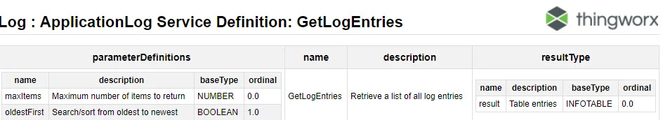

You can query the Logs entity, <ThingWorxServerName:portNumber>/Thingworx/Logs, e.g. there is default function like :
http://localhost:8080/Thingworx/Logs/ApplicationLog/ServiceDefinitions/GetLogEntries
or
http://localhost:8080/Thingworx/Logs/ApplicationLog/ServiceDefinitions/QueryLogEntries
or
