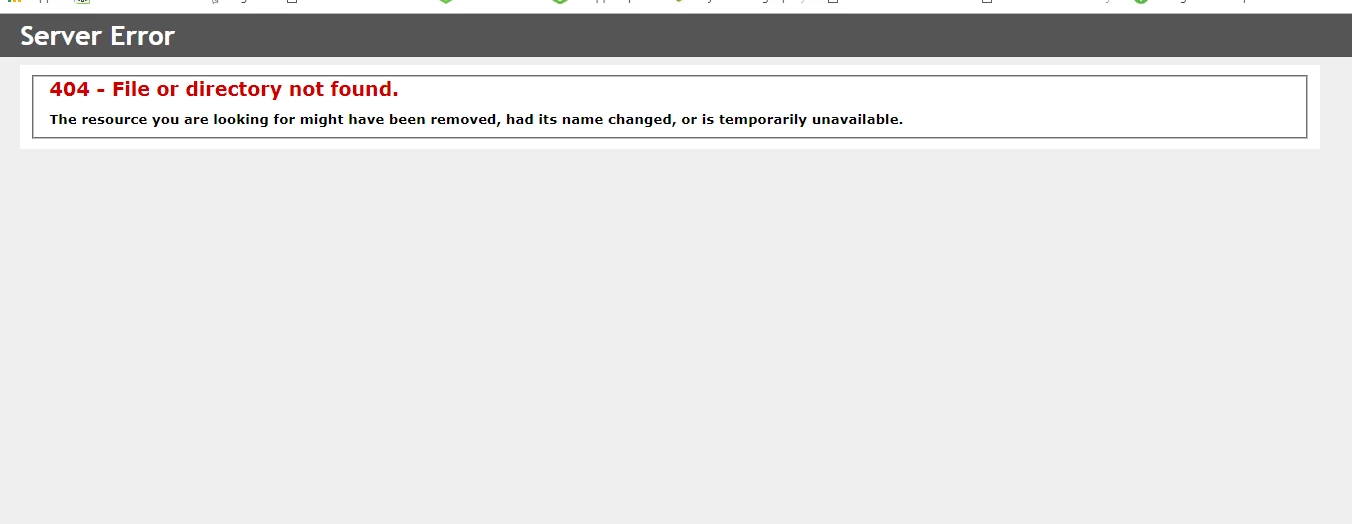

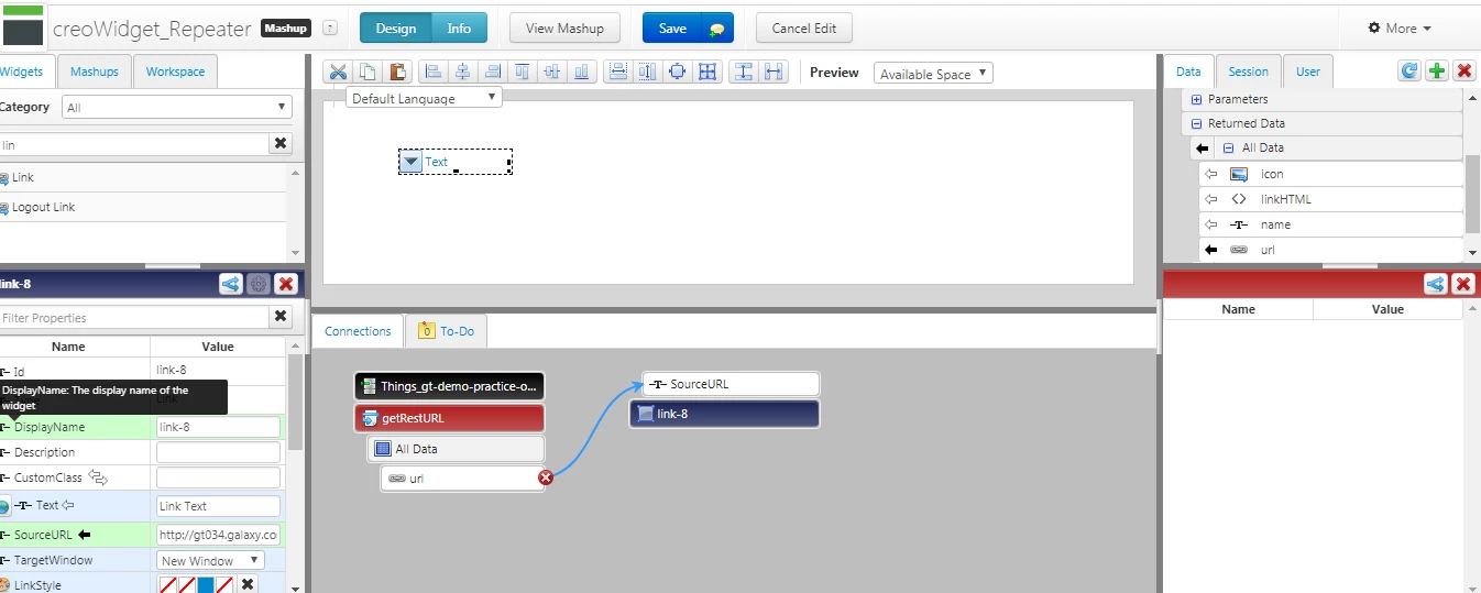

I am uisng Thingworx 8.3 and Windchill 11.1.
In Windchill connector there is a service called "GetCreoDataView" .  This service returns thumbnail, structure, files.
Files in service consist of file name, linkHTML, URL, icon .
But, I am not able to download file. linkHTML is not working and also URL.
How to use them, or is their any other way to download representation files?
linkHTML I get is ,
http://gt026.galaxy.com:8080/Thingworx/MediaEntities/ptc-windchill-integration-connector-proxy/Content/
servlet/WindchillAuthGW/wt.content.ContentHttp/viewContent/tank_drw.pdf?
u8&HttpOperationItem=wt.content.ApplicationData%3A586480&ofn=tank_drw.pdf&ContentHolder=wt.viewmarkup.DerivedImage%3A586468&forceDownload=true
&wt.effectiveUid=Administrator
Jan 19, 2019 4:30 AM UTC
Ok, to get Representation files from windchill,
there is a service in "ptc-windchill-integration-connector" called as "GetDesignFiles ".
just pass the parameter to it and you will get back JSON.
e.g. Create a custom service and paste the code below
var mycontent={
"objectIds": [oid],
"expand" : "Representation"
var params = {
request: mycontent /* JSON */,
CSRF_NONCE:me.getCSRF() /* STRING */
// result: JSON
var resultJSON = Things["ptc-windchill-integration-connector"].Content_GetDesignFiles(params);
