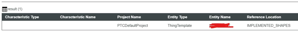

Jul 19, 2024 4:52 PM UTC
Hi @JK_10744682
I don't think we have a direct method to get the implemented thing template list.
You can use GetWhereUsed service to get relationship information - Using the GetWhereUsed Service (ptc.com)
Sample Code
// Provide your filter using the format as described in the help topic "Query Parameter for Query Services"
let query = {
 "filters": {
 "type": "EQ",
 "fieldName": "entityType",
 "value": "ThingTemplate"
// result: INFOTABLE dataShape: "RootEntityList"
let relationshipData = ThingShapes["SHAPENAME"].GetWhereUsed();
let params = {
	t: relationshipData /* INFOTABLE */,
	query: query /* QUERY */
let result = Resources["InfoTableFunctions"].Query(params);
Output :
/VR
